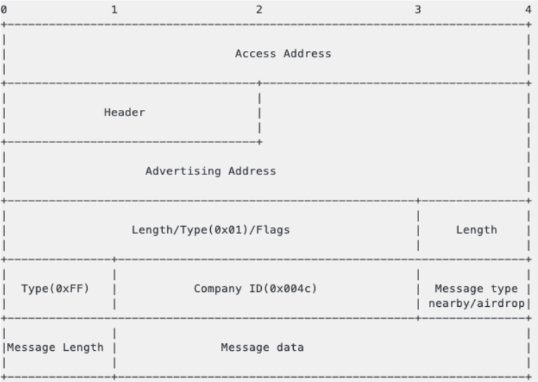

BLE packet analysis
By modifying the scripts from the py-bluetooth-utils package, you can view the BLE traffic sniffer. Apple uses ADV_IND messages to send device status.Advertise package structure
Nearby messages
Example of message types:0x05 — Airdrop
0x07 — Airpods
0x10 — Nearby
0x0b — Watch Connection
0x0c — Handoff
0x0d — Wi-Fi Settings
0x0e — Hotspot
0x0f — Wi-Fi Join Network
You can also get statuses from Nearby packages:
0x0b — Home screen
0x1c — Home screen
0x1b — Home screen
0x11 — Home screen
0x03 — Off
0x18 — Off
0x09 — Off
0x13 — Off
0x0a — Off
0x1a — Off
0x01 — Off
0x07 — Lock screen
0x17 — Lock screen
0x0e — Calling
0x5b — Home screen
0x5a — Off
As a result, you can create a simple BLE packet analyzer:

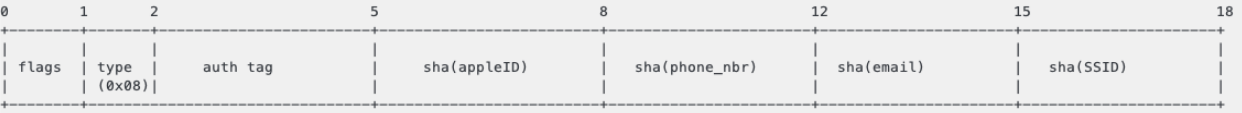

Wi-Fi
When trying to connect to Wi-Fi from device A, a packet of the following structure is sent, containing the first three bytes from SHA256 hashes AppleID (5-7 bytes), phone number (8-11 bytes), email (12-14 bytes):Presumably, Apple devices hash all contacts and compare them with those received in the advertise packet. When device B receives a packet with matching contact hashes, device B will offer the network connection password to device A.
If you generate a table of hashes of phone numbers for a specific region (about several million), then for the first 3 bytes of the hash, you can get a collision of the order of several tens of numbers per hash. There are two ways to check the correctness of the numbers:
- Some of the numbers can be excluded by checking them through the HLR ( HLR Lookup - Front Page - Index ).
- Since the number must be tied to the AppleID, you can check it through iMessage.

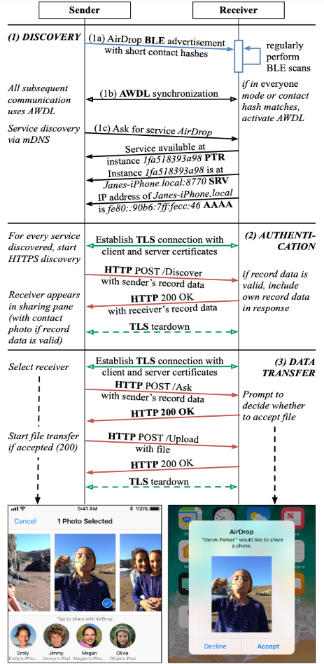

AirDrop
Apple AirDrop has three privacy settings:- Receiving Off.
- Contacts Only.
- Everyone
In this case, AirDrop is used only to initiate the transfer, for the very same data transfer, a peer2peer connection via Wi-Fi (AWDL - Apple Wireless Direct Link) is used.
During authentication, the sender sends sender's record data credentials to verify the recipient's privacy settings. This message contains the complete SHA256 hash of the sender. Thus, an attacker can respond to all other people's AirDrop BLE requests, receiving full hashes of numbers.
How AirDrop works:
